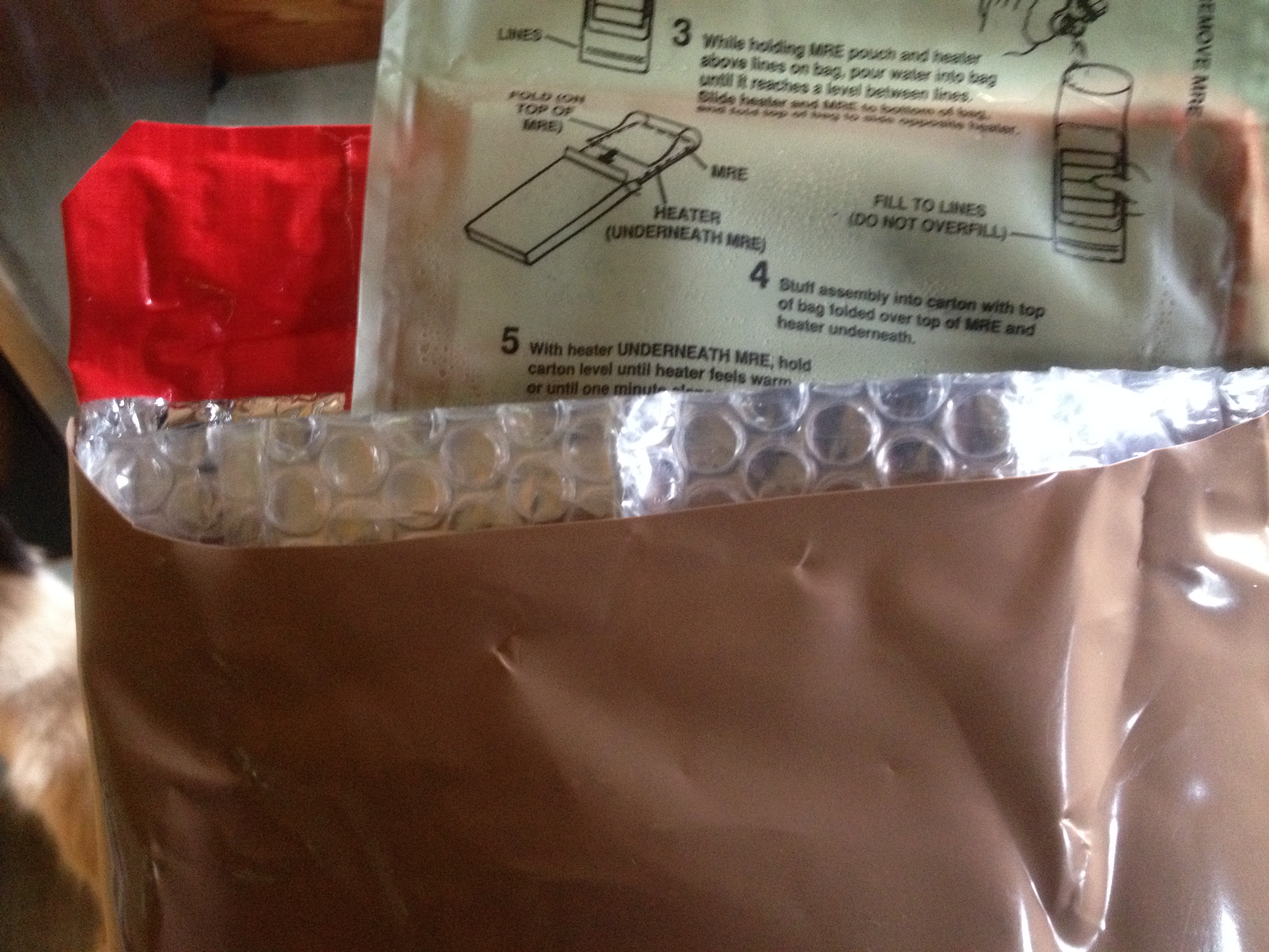

I had some of that Mylar/aluminized bubblewrap from some sort of refrigerated gift food that someone had sent us over the holidays and I thought that using some might increase the efficiency of the FRHs. It would also mean that I could lose the cardboard box when I'm headed out, and just take along the meal pouch itself.

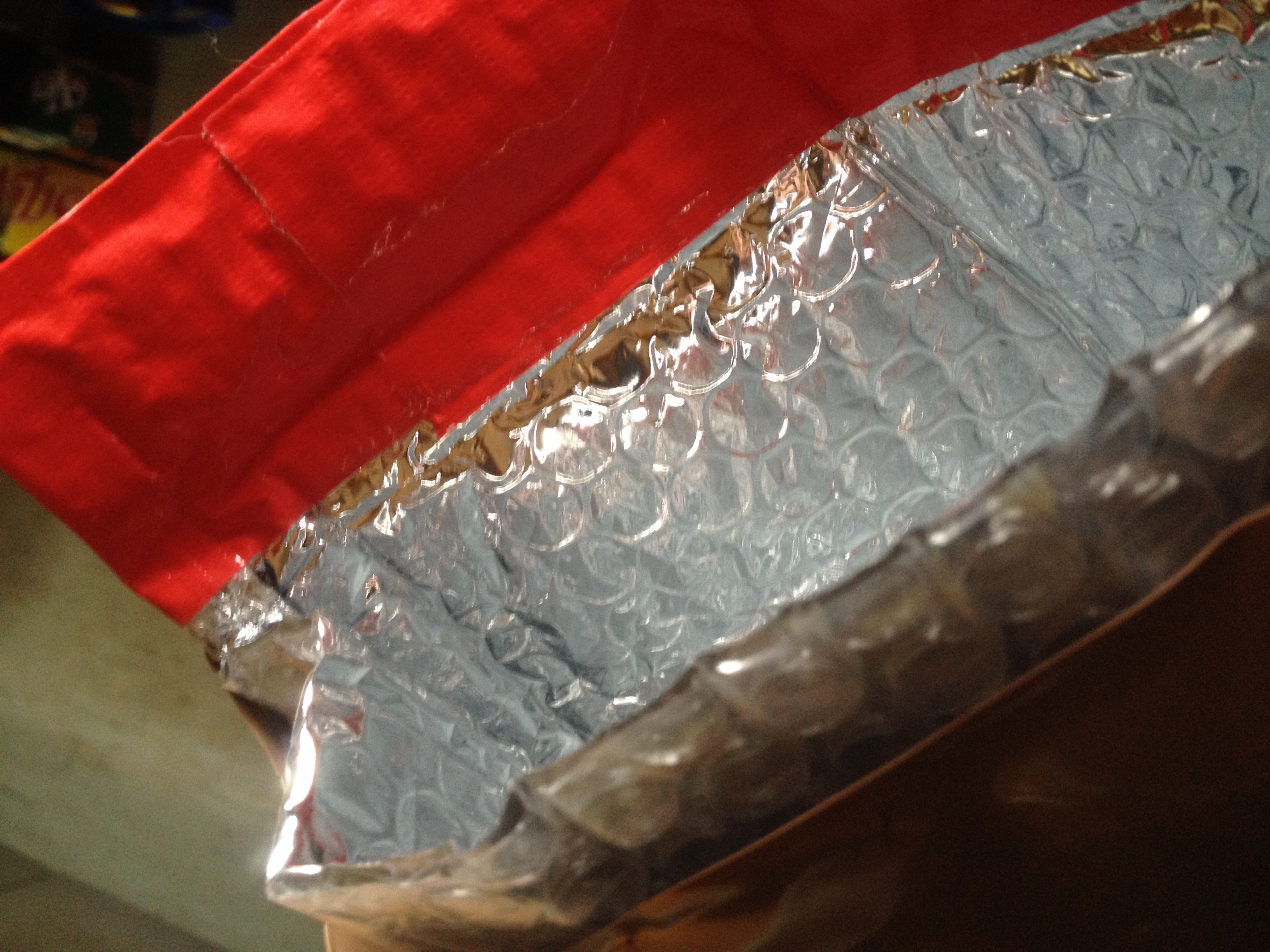

So, I took a standard MRE "brown bag", turned it inside out, cIlipped off the two bottom corners to make sure it would drain if there was any leakage, and slipped a secondary "bag" of the bubble wrap inside.
I cut the bubble wrap so if there would be a flap to fold up covering the bottom and another flap that could be folded over and tucked inside the MRE bag.
This is what the finished product looked like:
I added some duct tape to secure the two pouches together to prevent slippage.
Next is a filled FRH going in:

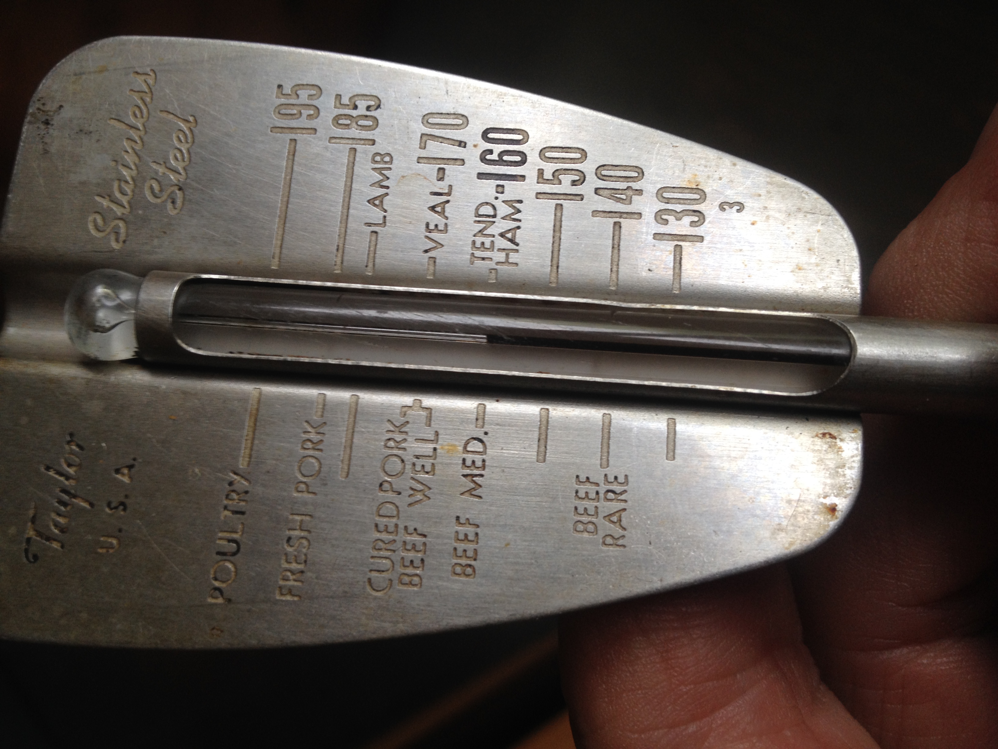

The results after 12 minutes on the timer: my meat thermometer showed 160°F.
While the FRH had quit "sizzling", there was still quite a bit of residual heat left. With the insulation, food could obviously be left for a much longer period of time, thus allowing the pouch to gain more temperature than it might otherwise.
As far as I'm concerned, hotter food is better food.
