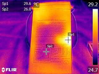

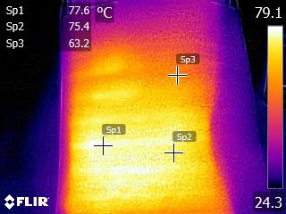

I was finally able to shoot and publish my testing of the US FRH heating up entrees using the standard MRE Entrée Box, MRE Entrée Sleeve and a Foam Sleeve from a Chinese PLA Type 13 ration. You will be surprised to see the differences......
US FRH in standard entrée box - Cooler side
Box - Cooler Side Start.jpg (156.39 KiB) Viewed 8341 times
US FRH in standard entrée box - Heater side
Box - Heater Side Start.jpg (177.11 KiB) Viewed 8341 times
PLA Type 13 Foam Sleeve with US FRH - Cooler Side
Foam - Cooler Side Start.jpg (196.99 KiB) Viewed 8341 times
PLA Type 13 Foam Sleeve with US FRH - Heater Side
Foam - Heater Side 12 Minutes.jpg (194.11 KiB) Viewed 8341 times

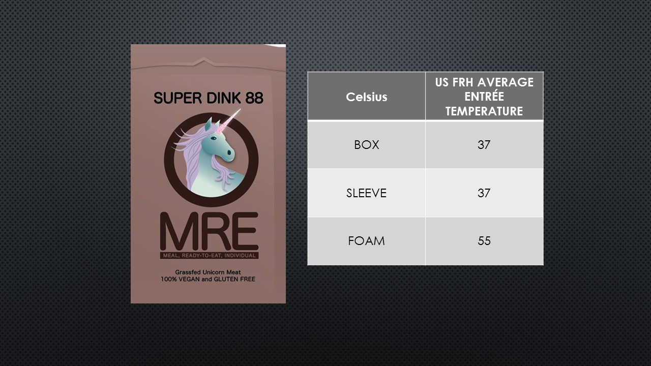

Calculated average temperature of Entree

Just to let you guys know. The color scal self calbrates to the temperature range. While these images may look the same picture to picture. Look to the scale on he right and specific temperature readings at specific points.

The temperature of the contents was the same for the box and sleeve but 18 Celsius hotter with the foam sleeve. The best explanation that I have is that the foam allows heated air to surround the entire entree and retains that heat. This enveloping layer of air is doing a better job of heating the entree.
The box and the sleeve actually sequeezes the air out of the entree and the entree is only being heated by contact with the heating elements.
