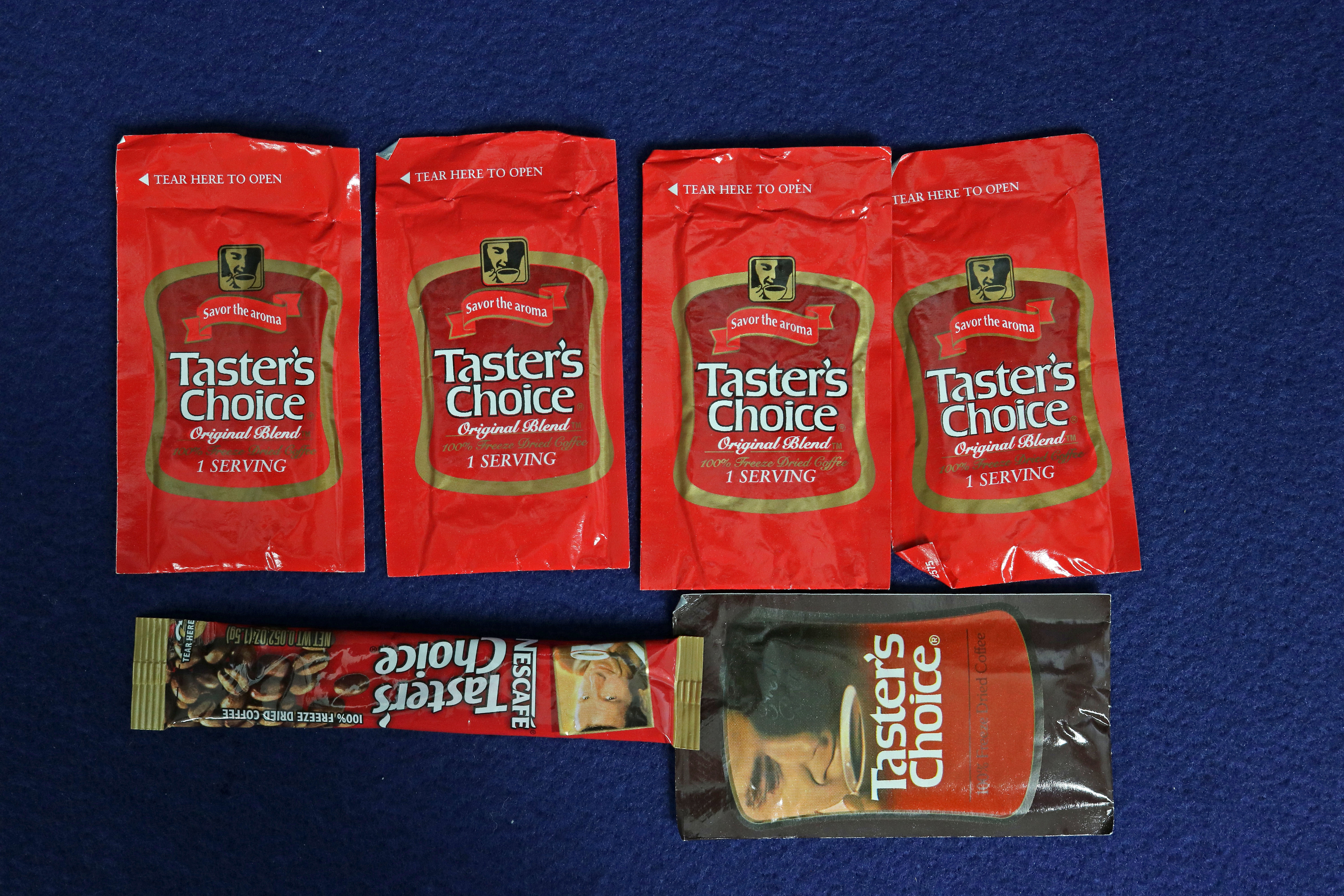

I have completed the investigation analysis of the white residue material associated with the aged red sachet Tasters Choice Instant Coffee which was made possible by the generous donation of a handful of samples from the collection of MREInfo member, SentientTootsieRoll.
The primary purpose of the investigation was to identify the white material sometimes found associated with the coffee crystals in some instant coffee packets which was suspected to be either mold or an ingredient of the coffee or processing aid which could be blooming to the surface. The techniques employed in performing this investigation were handheld photography, stereo microscopy, micro-chemical analysis, micro-FT-IR (Infrared Spectroscopy) and SEM (electron microscopy).

The first red sachet was opened and visually, no white residue was apparent as seen in the first image below. Upon inspection under the stereomicroscope, some fine white fibers were present on the coffee grain surfaces. This was likely the white material in question but there would not be enough of it for proper analysis. The following 2 red sachets produced coffee crystals with no white fibers present. Luckily, the 4th and final red sachet contained a large amount of white residue among the coffee grains which also appeared to be darker in color and clumped together implying moisture damage may have occurred.
