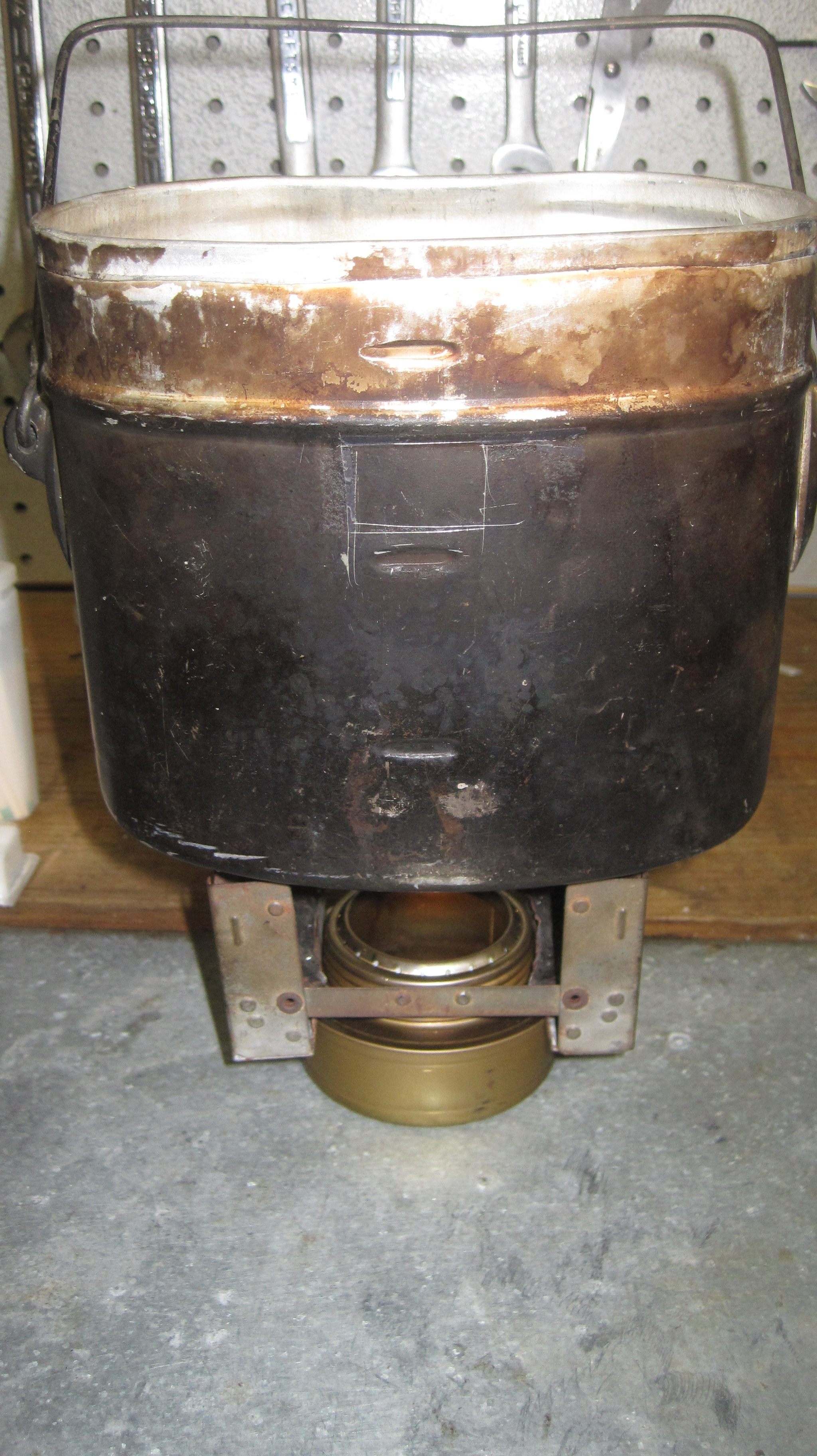

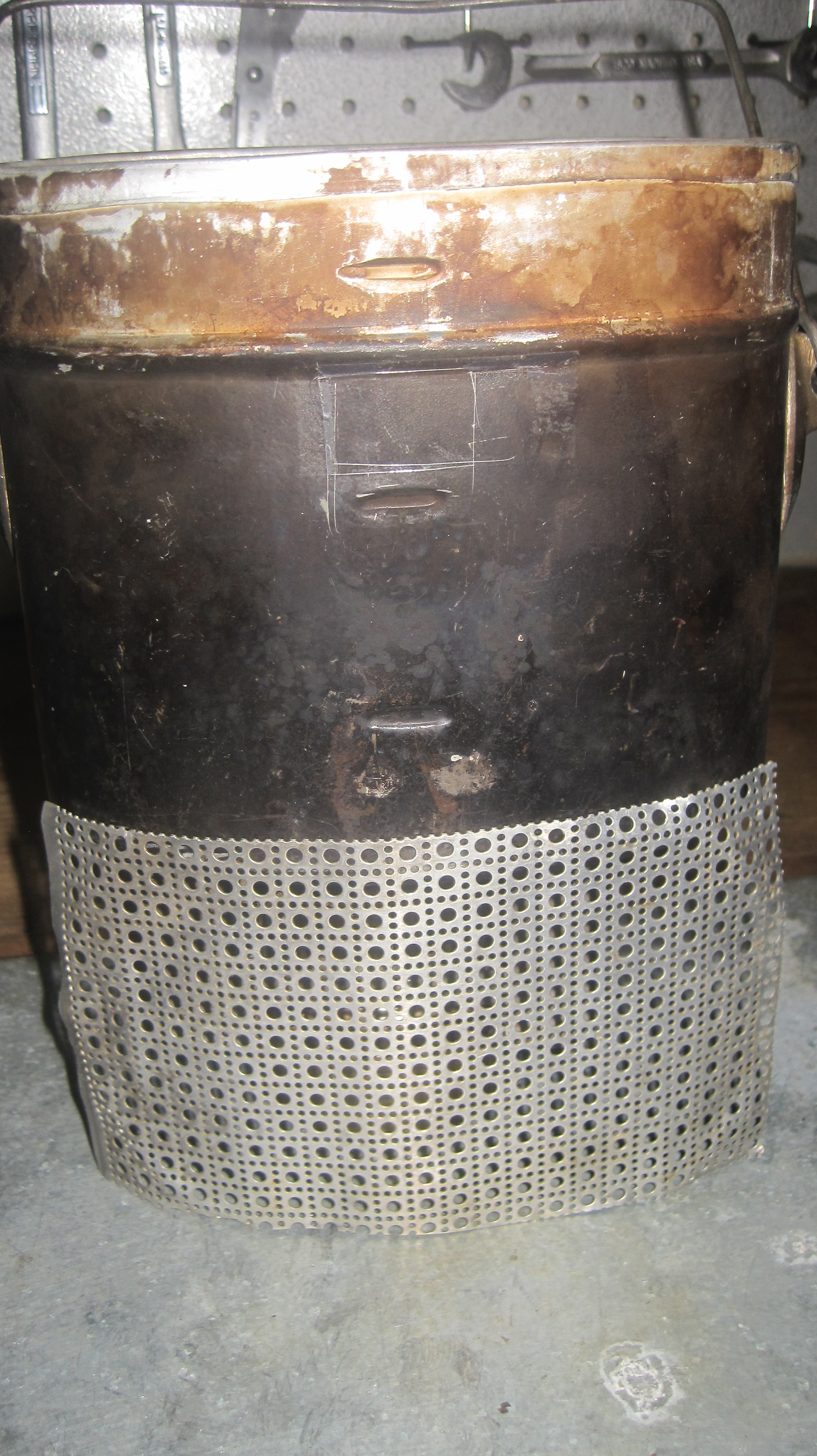

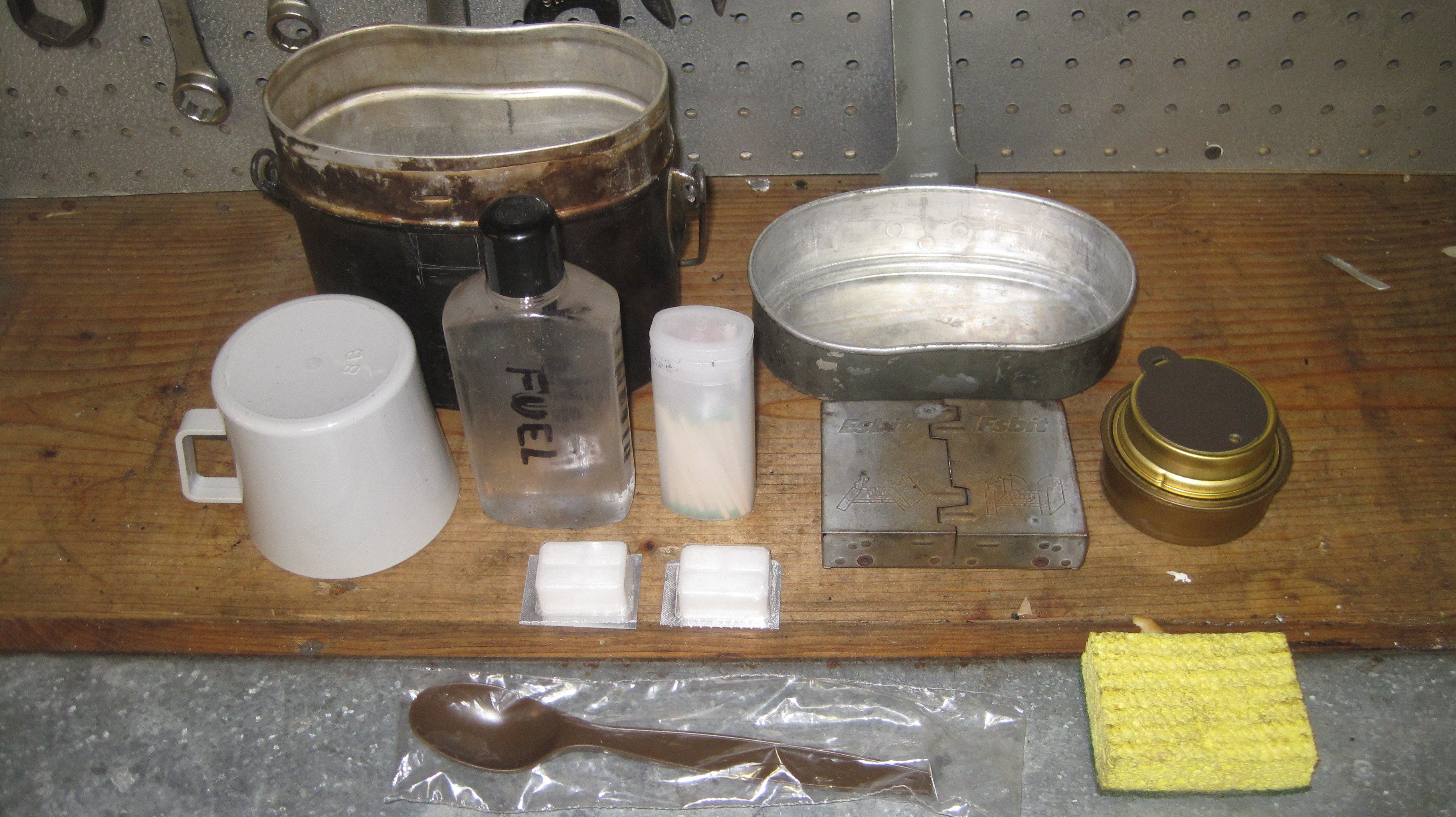

I like the older East German mess kit as it is light and compact. I wanted to be able to use the Esbit stove as a back up for the Trangia

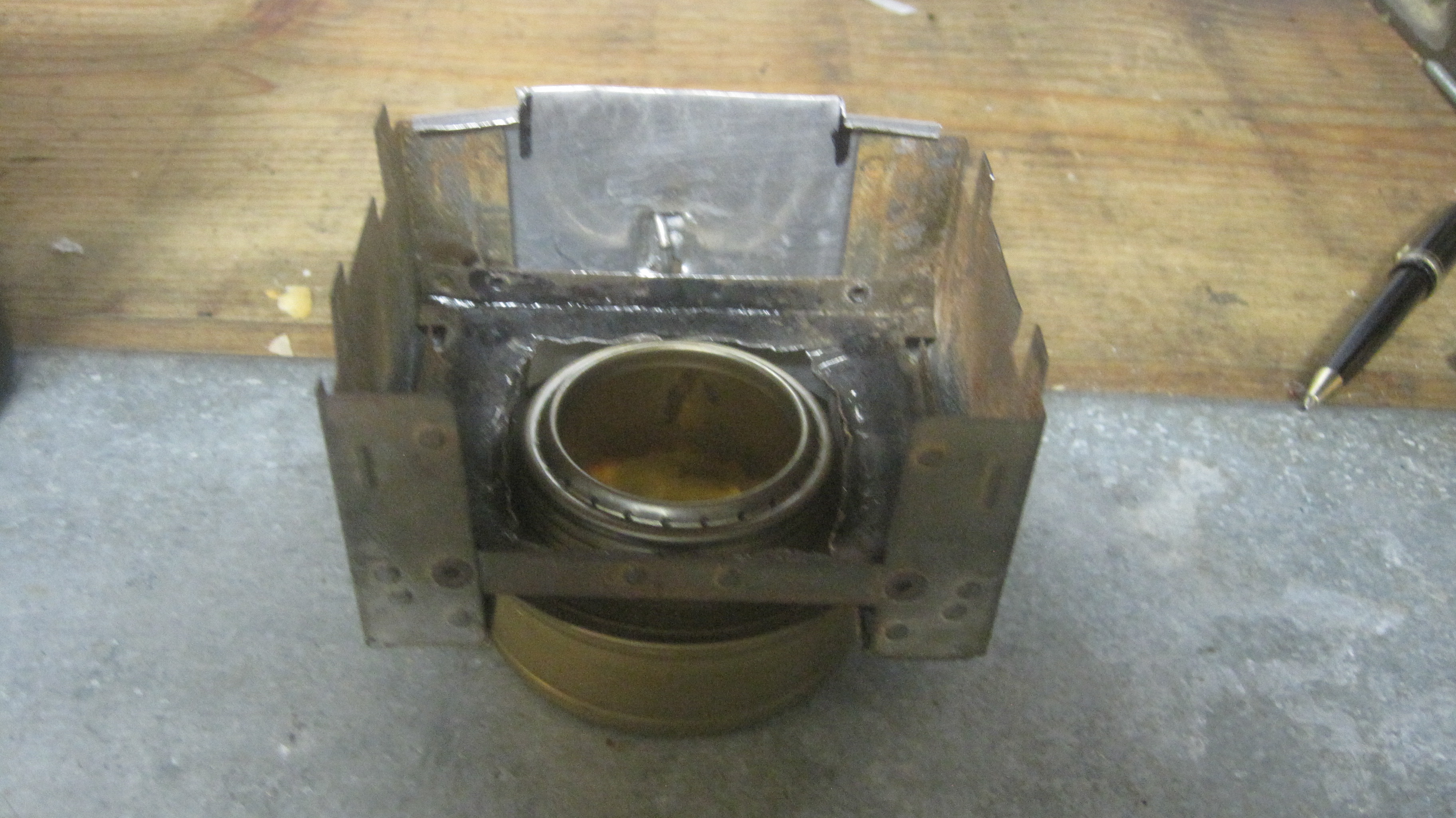

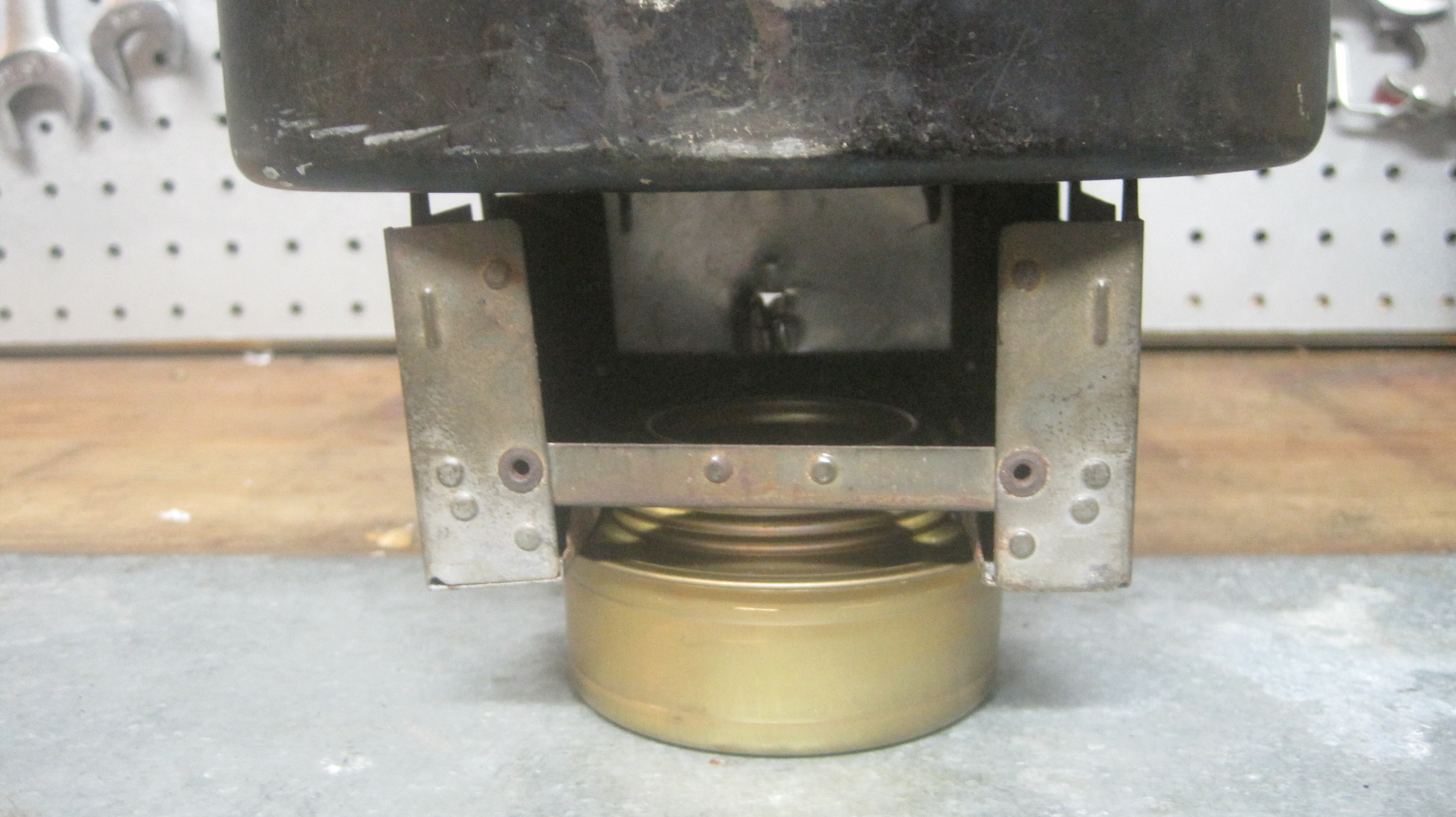

The problem I had was a windscreen and stove stand. So I cut a slot in the bottom to allow the Trangia throat to stick out.

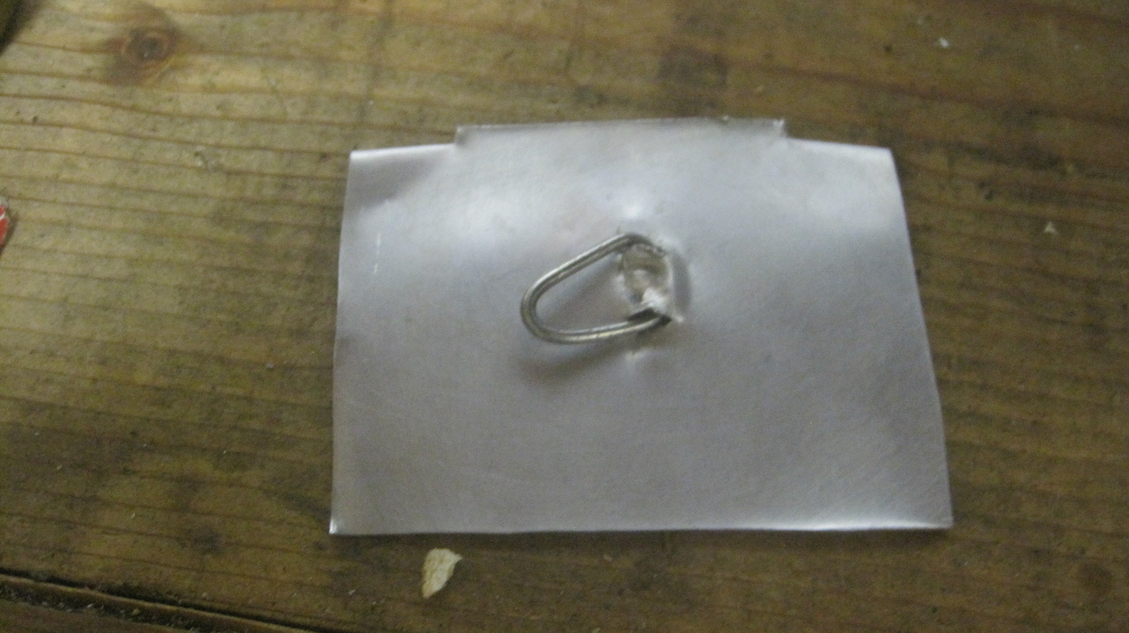

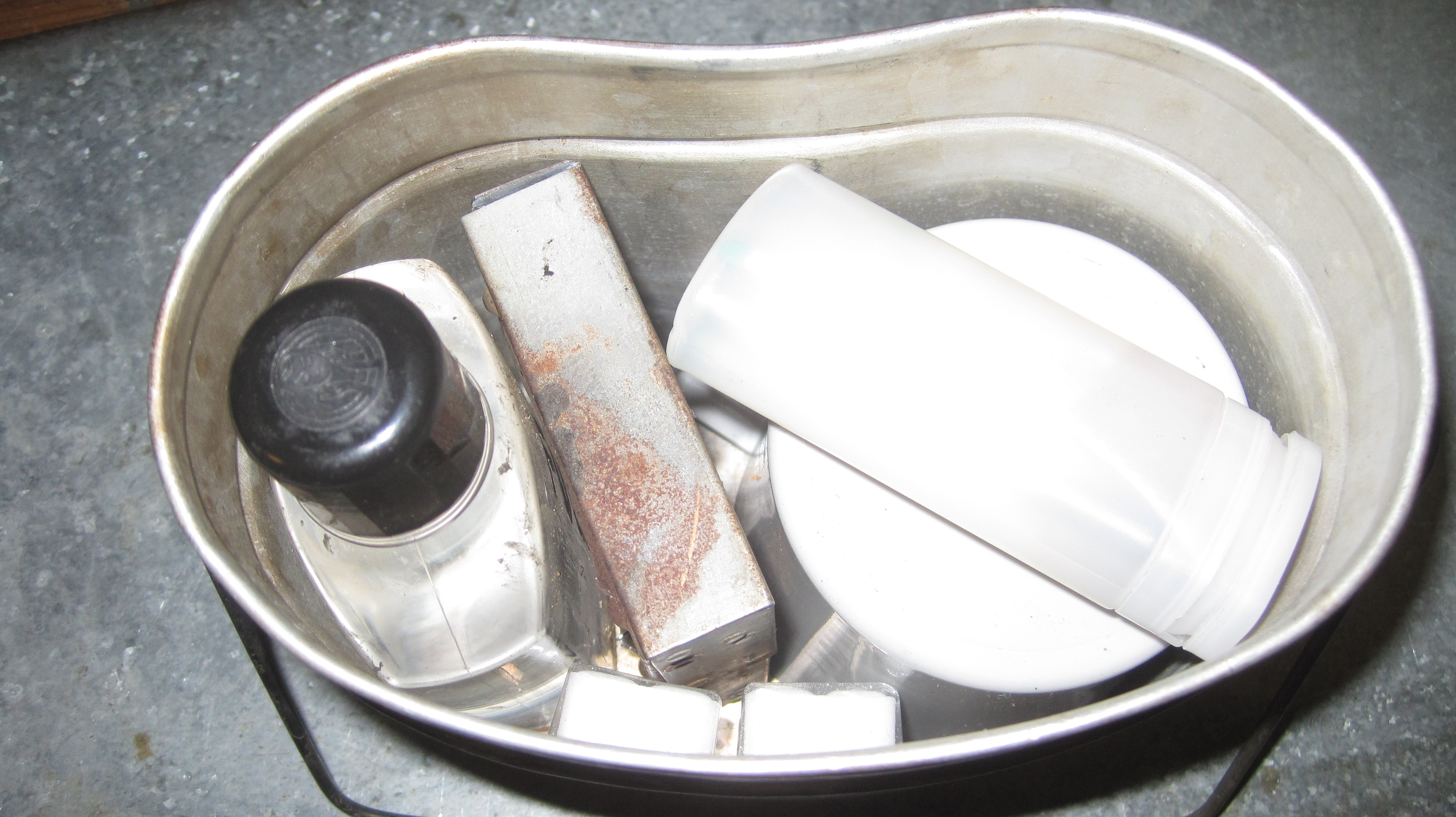

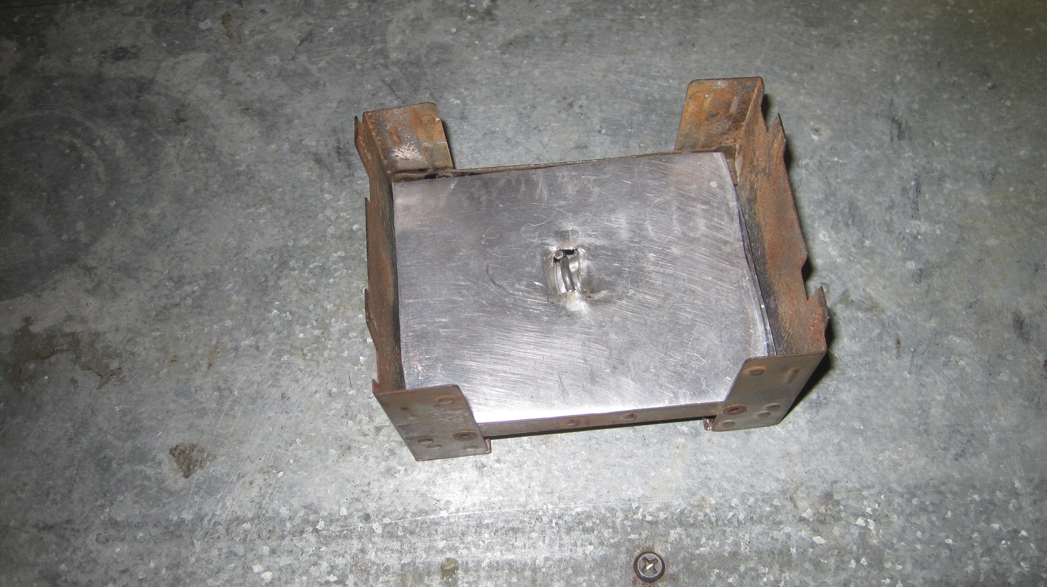

I have a section of aluminum to cover the slot if I want to use the the Esbit tabs. The entire set goes inside the pot set.
This contains the Trangia, Esbit, coffee cup ,spoon fuel bottle, container of matches, sponge
Tried it by boiling up some water for coffee and it worked great

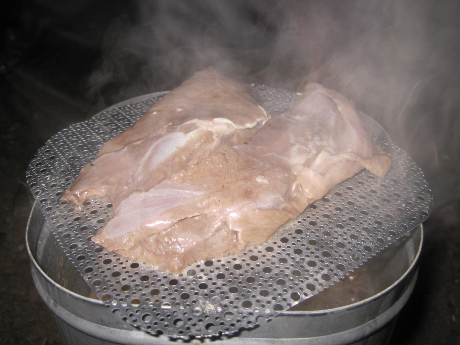

I use the this for boil in the bag cooking or boiling potatoes. You can also steam meat by laying a screen on top of pot, set the meat on the screen and cover with the pan lid. It works for small cuts of Lamb, Pork or Sausage.
The East German is about a pound lighter than the Swedish due the the Swede's windscreen and slightly more compact.

Set up as would be used in the field
For use with Trangia
Section of aluminum installed for Esbit fuel tab use

Packed away
Packed away

My immediate thought was that you want to add a little piece of aluminum to cover the back opening on the stove while the Trangia is in place. A piece of aluminum flashing cut to size with a quarter inch fold-over along the top could hang right on the back of the stove and provide extra wind protection. I always find with the Trangia style alcohol stoves that they have a tendency to flutter in the least little bit of wind and take much longer to get things to a boil. A piece of flashing would add minimal weight, for maximal benefit.
It's a clever little mod. The Trangia looks to fit at just the right height. I understand that the most efficient space below the pot is between an inch and a quarter and an inch and a half. With the optimal headspace being 1.4 inches. For any of these small stoves, regardless of the fuel, the flame-cone wants to focus right at the bottom of the pot without flaring too much. If you have flames licking up the pot sides, leaving soot and singeing the handles, your stove is up too close.

rattattoo
I did just what you said, bent two tabs over so it can hang over the back and act as a wind screen.
Measured from the burners to the bottom of the pot 1 1/2. Also use a very light tin screen as place to steam meats
This screen packs inside the main pot.
It works well if you boil fresh vegetables like potatoes and carrots. Set a section of lamb, deer or Bratwurst on the screen. Cover with the small pot and the as vegetables boil. The meat cooks without burning and the juice drip into the pot flavoring the vegetables . You get a good or at least better broth.
There is little mess to clean, this is a major issue with me. I do not like wasting water and time to scrub burnt food off aluminum pots. Plus it draws animals at night.
