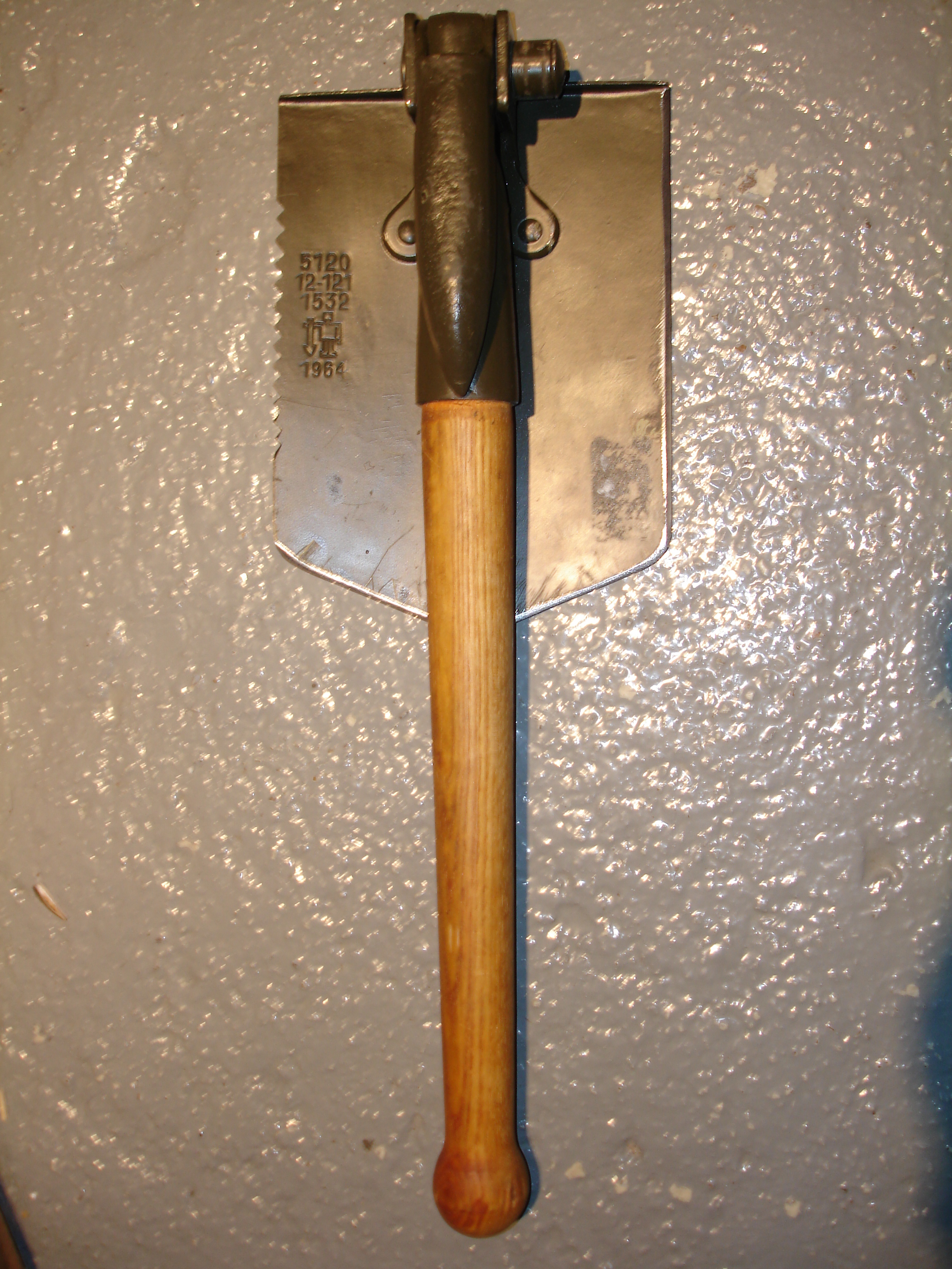

I would say that the Shovel modifications are about 75% done. Mostly fine sharpening and possibly adding a hanger with a leather string at the ball on the end of the handle. Do you guys think I should give it a stain on the top part of the handle near the blade and leave the 'grip' as is? As soon as the fine tooling is complete I will post some more pics!
I am doing this all by hand with just a few Steel Files, not even using a grinder. Doing it on a board on my lap with just my hands for holding, so it might not look perfect! When I am near completion I will finish it with my Arkansas Stones =)
Overhead shot with just the shovel blade flat out
I have it set standing on its own, with the blade and pick at a 90 degree angle. It looks like it would make one heck of a sundial!
Saw side which I am adding to the one edge. You can see the shiny section where I am just starting to add a sharp angle edge to it.
This is the 'machete' edge I was talking about. I just need to sharpen it a bit more, there is a definite angle to it and I tested it out on a board. Cut in about 1" with very little pressure!
My helper!
Modded 1964 German E-Tool Pic 01

@ Wookard, not to be a pain in the ass, but that saw isn't going to work efficiently, it is a tool to "stab" roots with (the serrated part). For sawing you need to get rid of the saw dust. So you need something like |\|\|\|\ instead of /\/\/\/\.
For getting through roots it will be very effective though. I think that's also the main use of a shovelsaw. For thicker branches/roots you have your pocket knife with little saw.
