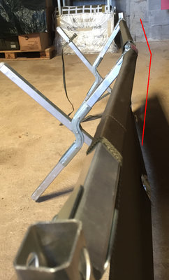

I´m now in military equipment for +30 years and when ever sleeping on a cot, it´s pretty hard to stretch the cover to get the square tubes in place.
I have one cot, the cover is so tight, it bends the whole cot, once you made it to get the tubes in place:

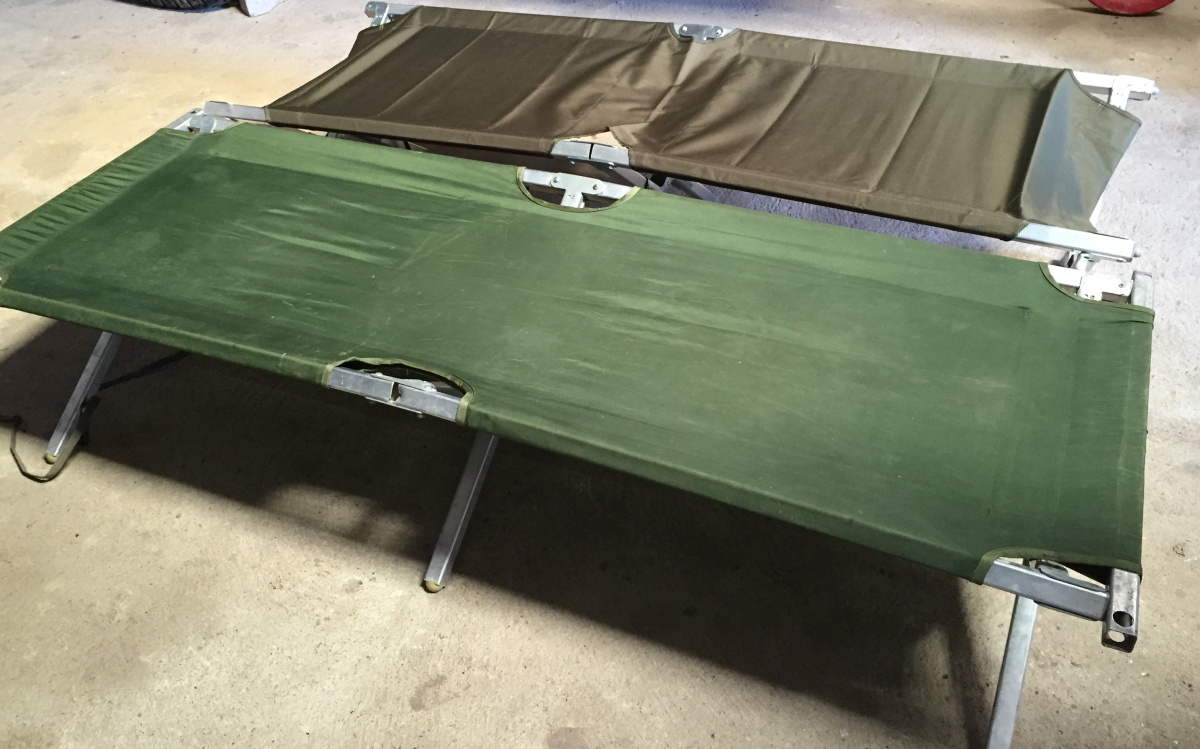

Beside is another, older cot with a little "worn" cover:
It´s OK to set up and it doesn´t bend the whole cot.

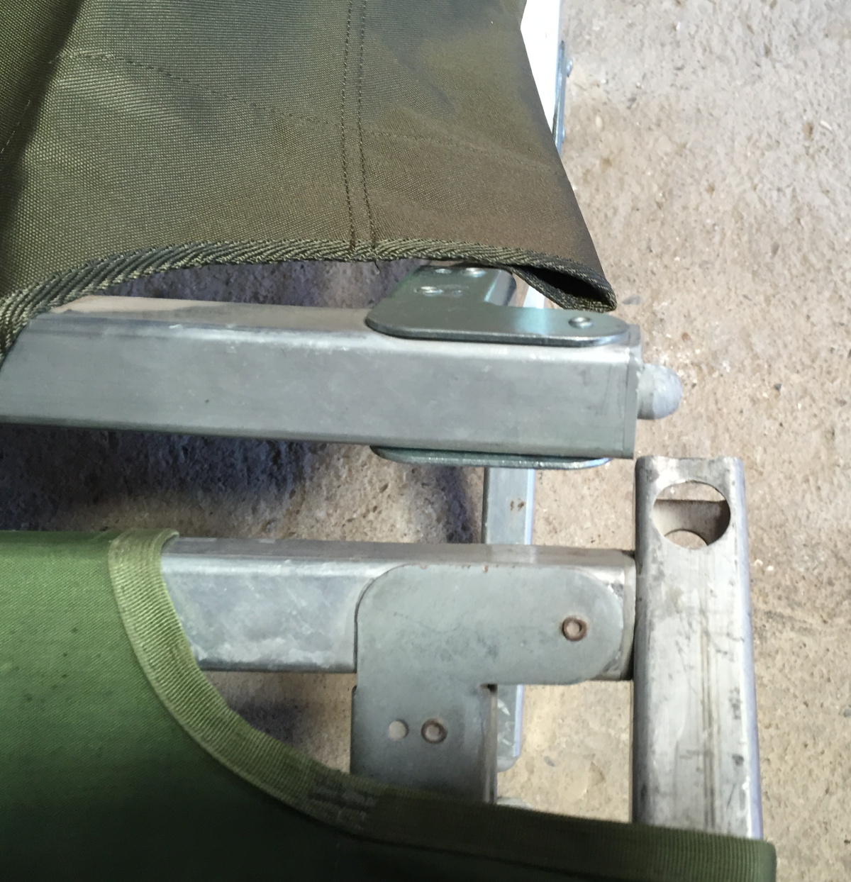

Oooh the old military cot! This was the problem every time when we used them in the Army. As a result we learned to just sleep on the ground anyways.
As far as I know, there is no way to stretch the fabric out.
What I would do is first put the loose bar through the cot fabric on the end, next, wedge the loose bar onto just one of the two ends of the cot, then pull outward toward your body to stretch the cover far enough to set the other side of the loose bar onto the other end of the cot. Then to disassemble just pull outward toward your body on the bar.
You can do that, or honestly some guys don't even attach one of the loose bars at all. I also have never seen a cot damaged from stretching it out and attaching both loose bars, so either way, you are safe I think.

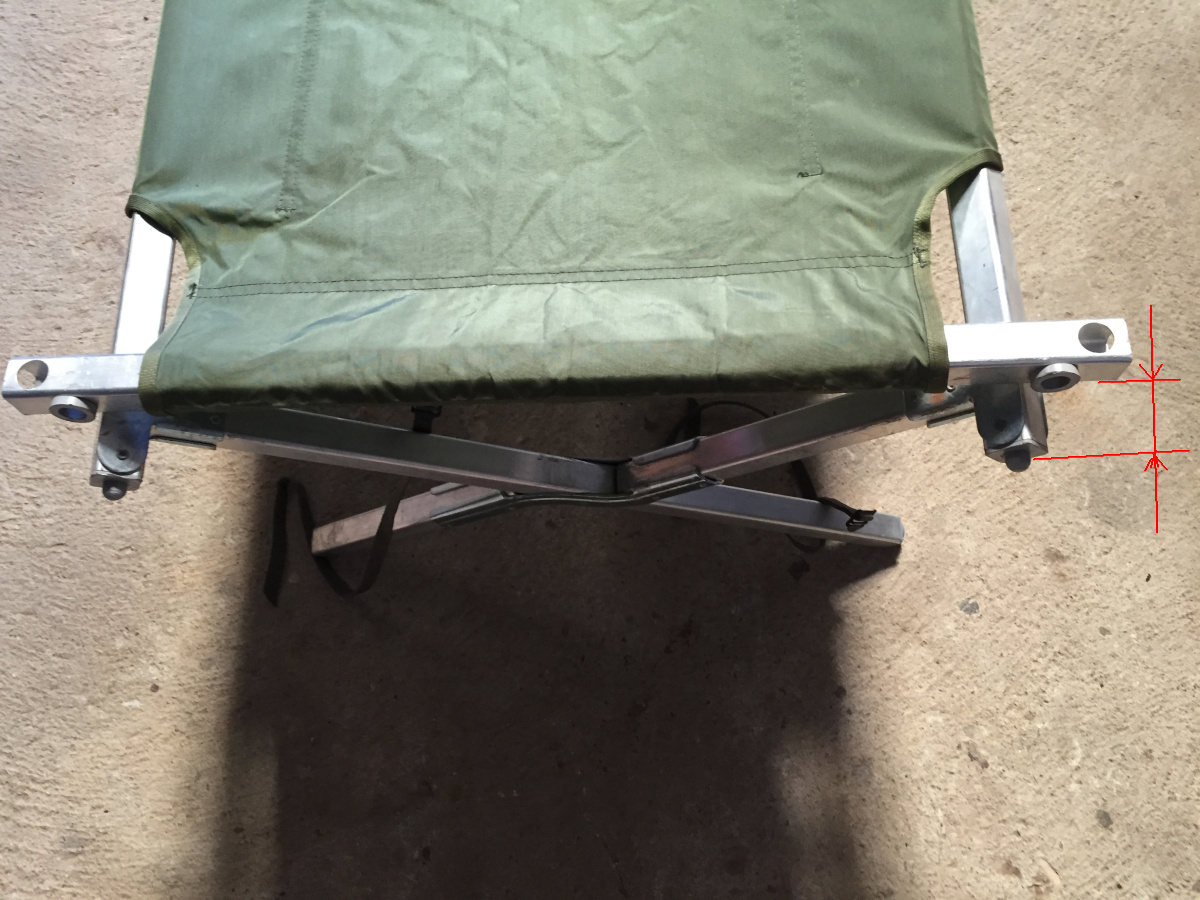

Yes, that´s how we do it too but that frame seems to be too long :shock:
At least, I´ll change to positin of the holes and remove some "material" to shorten the frame.

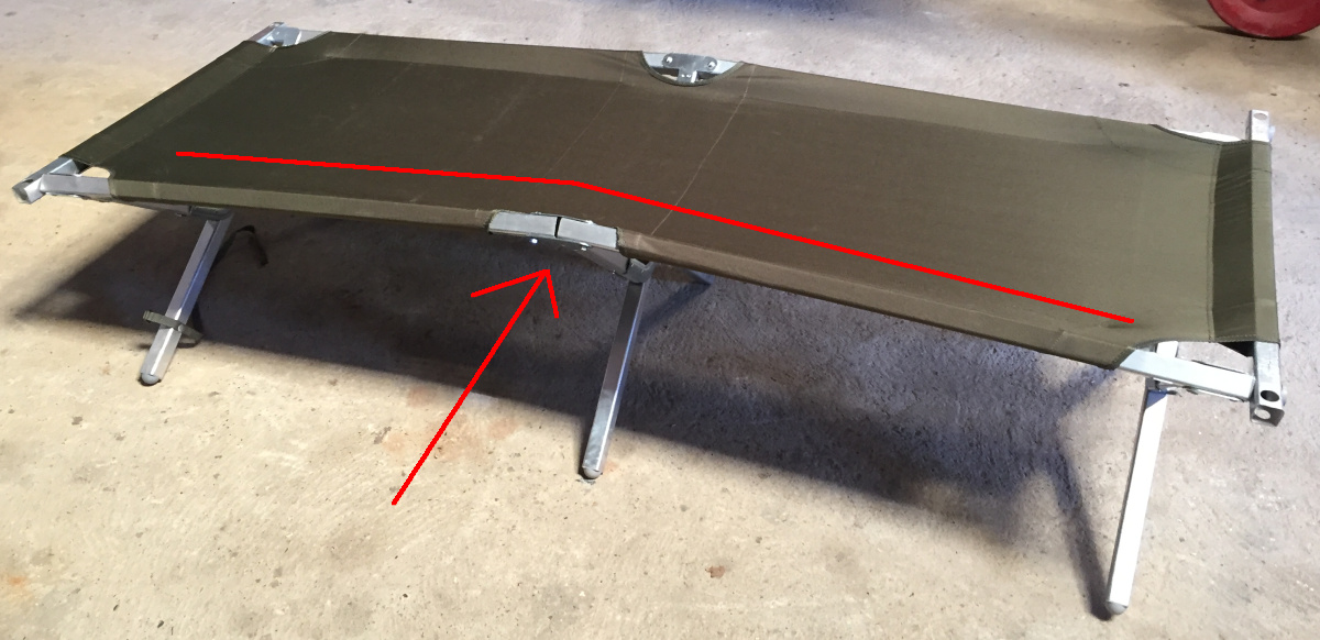

Housil, every cot I have seen looks just like yours though and has the same problem, so your not alone. But, it actually should make it easier to remove a small bit of material from the metal sides.
Posts: 5636
Re: Need idea about too tight cot cover
Post by housil » Thu Sep 01, 2016 5:45 am
cavguy wrote: to remove a small bit of material from the metal sides.
Too bad you can´t just remove a little of each end due to the hinges

Another thought is to cut the rivets and shorten the sides. Then just drill new holes and use Chicago bolts with some lock-tite to put it back together.
Posts: 5636

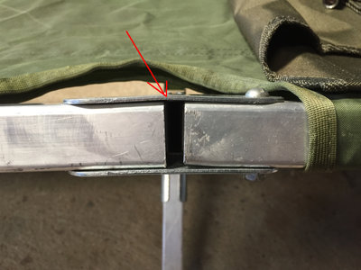

Post by housil » Sat Sep 03, 2016 5:57 am
shawker71 wrote:Another thought is to cut the rivets and shorten the sides. Then just drill new holes and use Chicago bolts with some lock-tite to put it back together.
I will drill new holes in the middle hinge so I don´t have to replace the rivets and cut the frame there a little.
