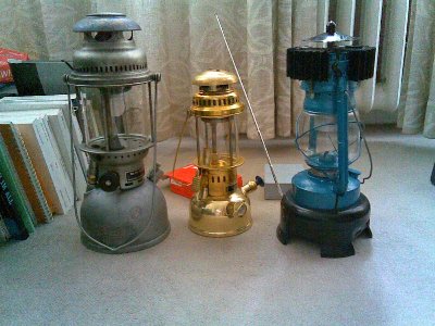

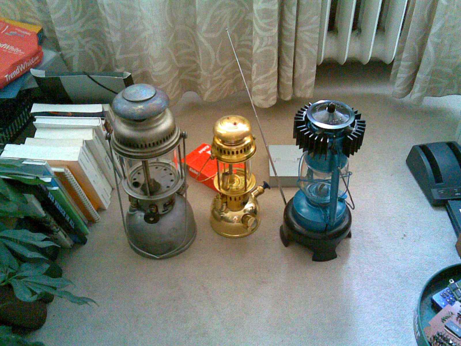

And thats my LUFO (beneath some really pretty lamps)

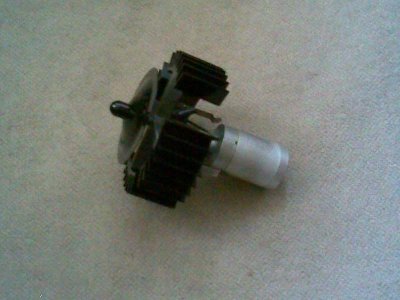

Here ist another picture of the thermal generator removed from the lamp.
You can see the generator pile (about 70mm long and 40mm diameter) with the attached heat sink.
