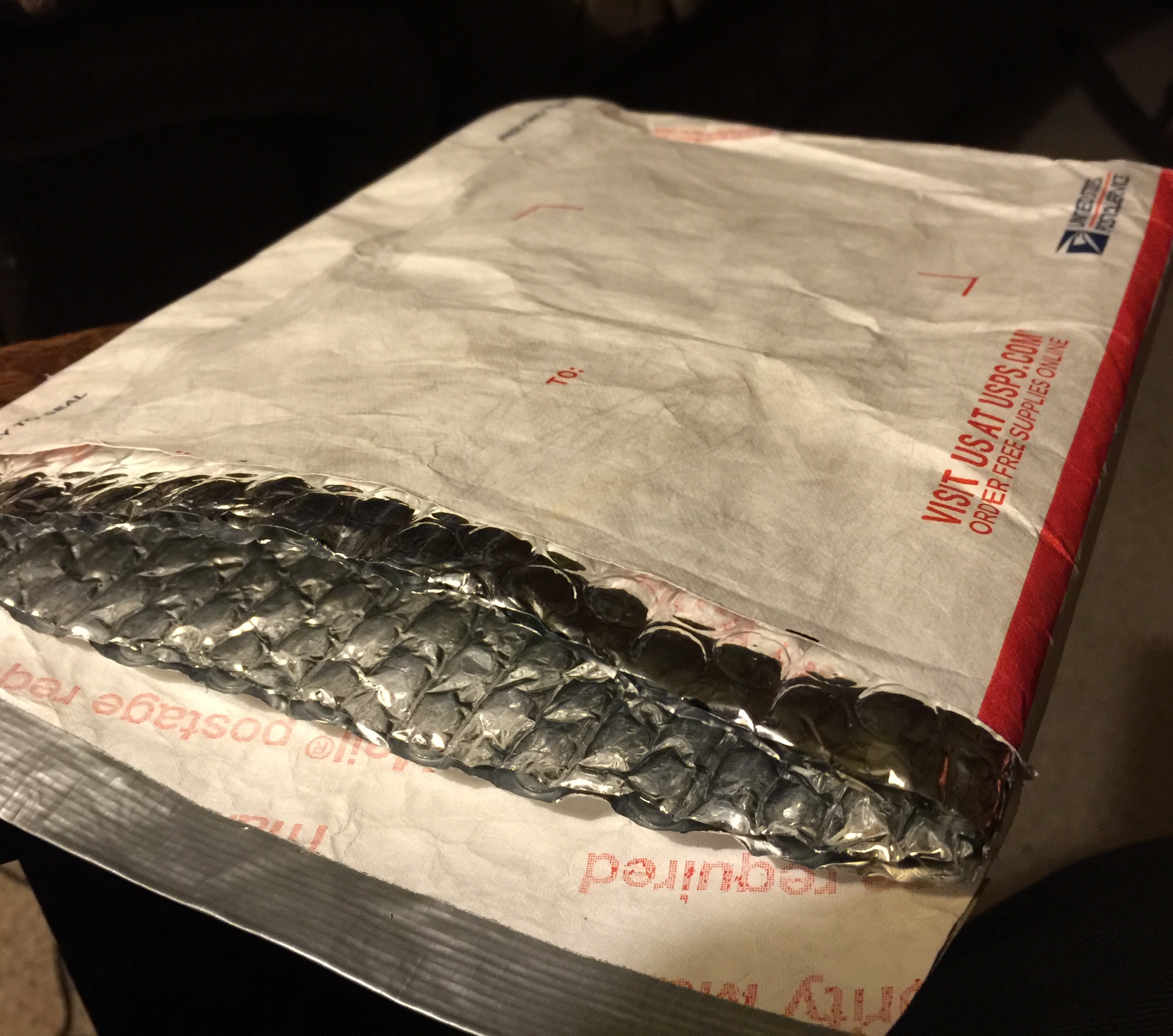

I totally dis-remember if I have actually posted this in another thread, but this is my solution for boosting the power of the FRHs.
A used Tyvek mailer, lined with the foil mylar bubble wrap used in housebuilding. Lightweight, relatively sturdy, and it seems to increase the efficiency of the FRH's considerably.
Like RockyRaab, I only put the water in the FRH bag and slip my MRE pouches in on either side.
