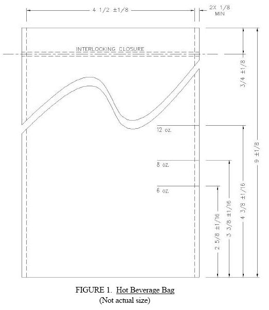

I was just browsing the MRE XXV (2005) PCRs (Performance-based Contract Requirements) over at the DSCP's web site and noticed a new addition - the "Bag, Hot Beverage". From reading the PCR, it looks like this is a bag that you fill with 12 oz. of water and then placed in an Flameless Ration Heater. Six minutes later...hot water for your coffee, tea, or cocoa. Here are the instructions from the PCR:

As for the what the bag is made of of, it says "high density polyethylene film (HDPE) of a minimum 0.002 inch thickness...constructed with 1/8 inch wide heat sealed sides and a folded bottom."
Here's a picture of it from the PCR (click to see a larger version):
