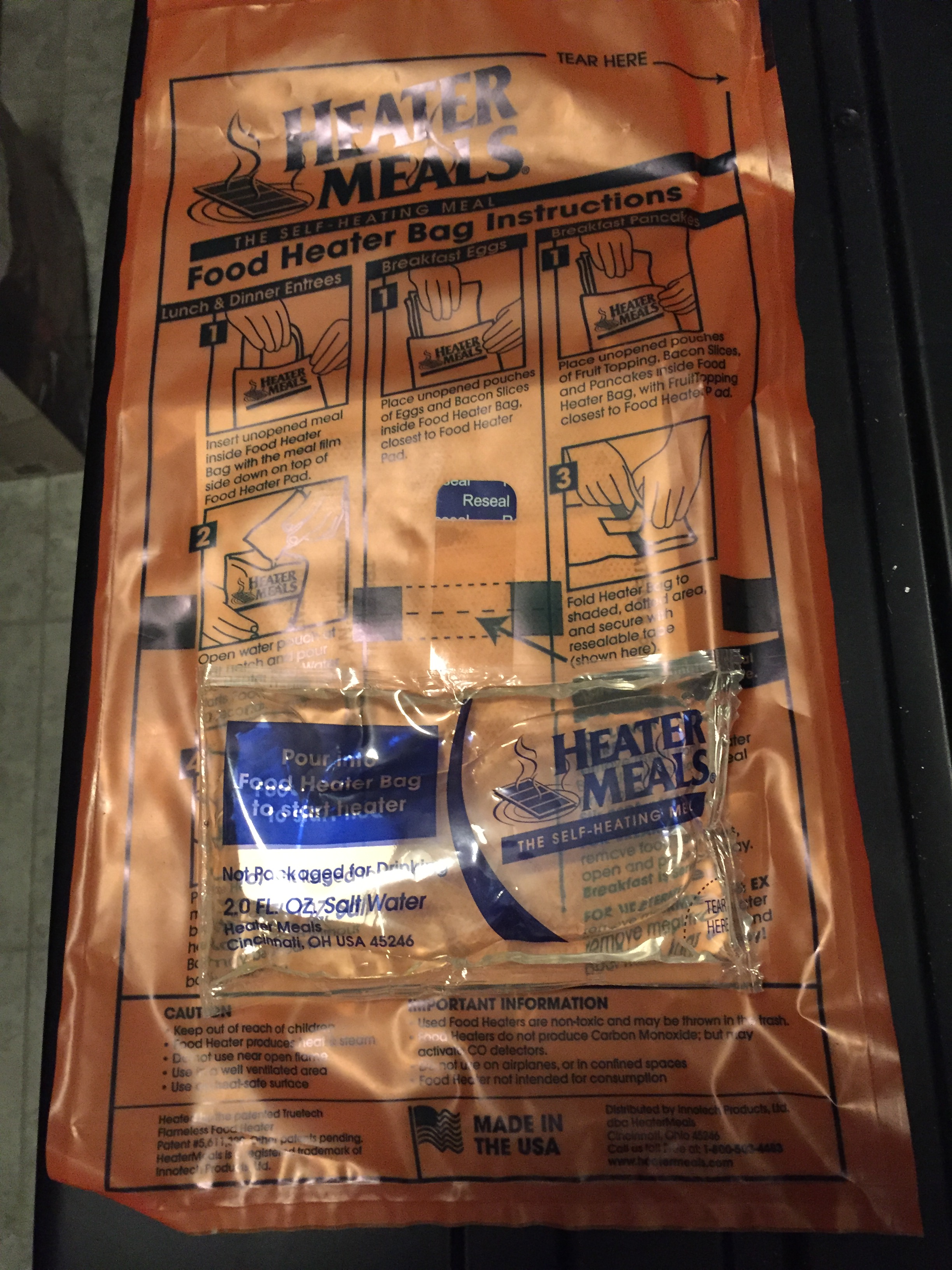

I did a little more research on these. Truetech is now Luxfer Magtech Inc. They also make ( Heater Meals ) A civilian MRE. There is a small packet of salt water inside the heater pouch. I did also find their spec sheet and the heaters with the salt water pouch inside are classified as Dangerous goods & will be a problem in shipping.

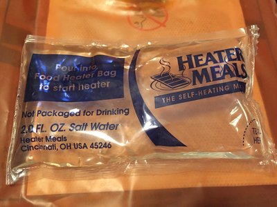

henner wrote: They also make ( Heater Meals ) A civilian MRE.
They call them self the inventor of the FRH.
henner
Posts: 15
Joined: Thu Sep 11, 2008 11:50 am
Re: Salt water activated MRE heaters ??
Post by henner » Thu Mar 02, 2017 11:34 am
Thank you housil for posting the pictures.
