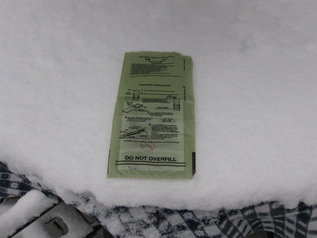

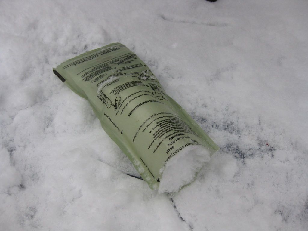

Wanted to know if the heaters that are in the tan mre bags can be activated with snow?
Thought of sending some of our MRE meals with son inlaw while snow mobiling here in Colorado.
Do the MRE meals freeze and make it harder to heat them ?
Re: Heaters can we use snow?
Welcome to the forums, honey. That's a pretty good question about the snow. If only we had some snow around here, I'd go outside and try it myself right now...but alas, it was 60 degrees today so I can't help with a live demonstration.
I'm guessing that snow would work but you'd have to pack a lot of snow in the heater seeing as snow takes up to 10x the volume of water.
As for MREs freezing, they do freeze and if they get cold enough, it might actually take two heaters to get them warm enough. Depending on how much equipment you might be bringing, you want to bring a small stove and heat up a pot of water. You could put the MRE entree in the water to heat it up and then use the water for drinking afterwards.
you can use snow or iced water too.
Last night, as I was outdoor, my little water bottle, which I used especially for the FRH, was frozen in the morning.
So I crushed the ice with my knife and filled some pieces of the crushed ice into the FRH.
It tooks more time to heat up the entree but it worked.
I think it took about 20 long minutes until the entree (sloppy joe filling) was hot enough to eat.
The best way is to have somethin liquid only in exceptional cases I would recommend ice or snow.
